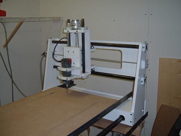

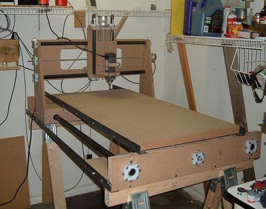

Hi Guys,
A couple of weeks ago i decided to build a CNC Machine but saw that most plans and building costs where cost prohibitive, I then went to www.cnczone.com and found DIY Plans for a wood CNC Router made from MDF. Many people have made this unit from the FREE plans available from the site. Don't let the MDF fool you, this is a very nice machine when properly sealed with shellac and paint. most are getting an accuracy of .005 in and 30-110ipm cuting speed depending on the size stepper motors used. Construction cost including electronics is $300-$500 (486 or greater coputer not included). I've decided to build this model myself. To get the plans you need to goto the site and register for free and then you can go to the download page and look for the file with the name JGRO you can also do a searh to read all the post about it. Enclosed is a picture. Tell me what you think of this Idea for rough carving archtops ect.

"X" ,"Y" and "Z" lead or drive screws what type and size of thread?
What are the follower bushing that correspond to the lead screws made from

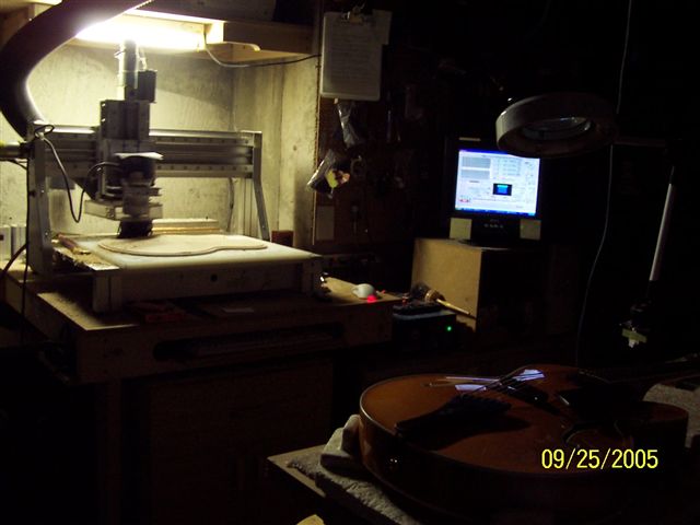

Ed--I use a similar sized CNC for rough carving my plates. It is a Techno-Isel with servo motors retrofitted to replace the steppers.
One issue to consider is the duty capacity of the router motor used. I run the Bosch 1617EVS which works okay but have to replace the bearings occasionally. Could probably slow down the cutting feed rate and get more router life but get tired of hearing the noise.
One way around that is to go upstairs and surf the OLF while it's running.
I use vacuum to hold the plate while roughing the outside and then have a clamping setup for roughing the inside.

Nelson P.S. Here's a shot of my CNC roughing out a top plate.

Brock, As far as the software there seem to be many low cost solutions < $150. As far as steppers vs servos, servos cost more and are faster but my friend who works with many cnc machines say's that servos are not as reliable as steppers. My friends say's they have to change out the servos every so often on most of the machines they have that use them. I'm a newbie to this so I really can't say that this is the case for all servos.
Nelson, That is a great looking machine. Did you build it or purchase it? how do you like cnc? do you have any trouble with your servos?
As far as the scew it is an acme unit about $24 and uses Delrin for the follower bushings I think. Sorry I'm not use to the terminology yet.

Ed--I bought the Techno-Isel on Ebay several years ago. It had steppers on it with the Techno-Isel control. I retrofitted it with servo motors with encoders and bought a control from a fellow in Canada.
I also have a little Maxnc10 benchtop mill that I've used for several years for making small parts such as the tailpiece, pickguard, bridges, headstock machining, inlays and inlay cavities, fretboards etc. It originally had underpowered steppers so I retrofitted it with servos and drives also.
I like CNC because, as I alluded to above, I can be messing around on the OLF while the CNC is carving a top for me, as it is at the moment. Seriously, it is very productive to be able to do something else while the machine is running.
Nelson    P.S. I use the Mach2 controller software.

Well guys I'm going to go ahead and start building one next week. I'll keep you posted and let you know what problems I run into and what observations I have. Nelson, what is the cutting area of your machine? I'm going to build one about 2'x4', I've always wanted to try and build a cello.

What Z axis travel/clearance would you recommend?

Ed--I have about 6" travel on Z with the lowest point putting the router collet at about 2" above the table. The 6" is probably enough but there are times I need to get the tool down a little closer to the table depending on how the workpiece is fixtured. I can reposition the Z slide base lower or higher but would rather avoid having to do that.   I have some setups where I have to mount a tiny endmill in an extension sleeve to get the cutting edge to depth.
Might mention also that dust control is a big issue with a CNC router. I built a plexi housing with "walrus whiskers" hanging down to "seal" the chips as much as possible so the airstream can pick them up.

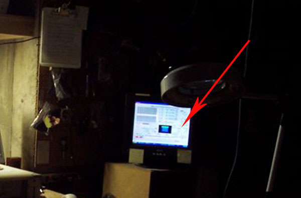

Nelson, Mach2 does do on the fly feedrate changes. The control is right here:
Maybe if you turned some lights on....
John Watkins

I do override the feed rate but it doesn't take effect until there is a change in Z.
